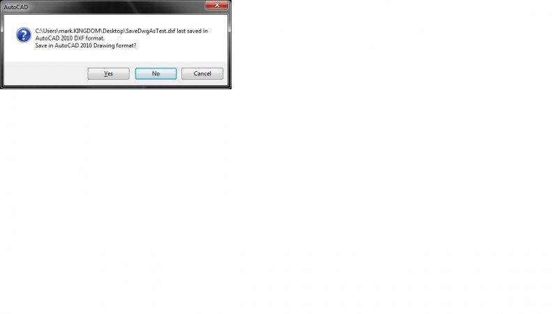

mizeddie Posted June 27, 2011 Posted June 27, 2011 We save all our drawings as DXF... which is our default. After it saves it always asks if we'd like to save as a DWG, is there a way to turn off that "reminder"? Thanks, Kari Quote

SLW210 Posted June 27, 2011 Posted June 27, 2011 You should be able to create a macro and use a button to close and automatically answer No. Seems there are no system variables to suppress that I could think of. Quote
Jack_O'neill Posted June 28, 2011 Posted June 28, 2011 If you've set it to save as a dxf in the options dialog box on the "open and save" tab, it shouldn't ask you every time you save the drawing, only when you close it. Or at least, that's how it works in 2010. If it is, that might be a bug to report. Quote
SLW210 Posted June 28, 2011 Posted June 28, 2011 If you've set it to save as a dxf in the options dialog box on the "open and save" tab' date=' it shouldn't ask you every time you save the drawing, [b']only when you close it[/b]. Or at least, that's how it works in 2010. If it is, that might be a bug to report. If I understand correctly, that is the problem. You can save as .dfx, but when you go to close the file, you get that pop-up asking if you want to save as .dwg. Quote

ReMark Posted June 28, 2011 Posted June 28, 2011 This is the message I see after having first done a "save as" to DXF file format then trying to immediately close the drawing. I'm using 2012. Quote
pendean Posted June 28, 2011 Posted June 28, 2011 AutoCAD's file format is DWG: DXF is the exchange format only. Instead of SAVEAS and manually reply, automate with a macro as noted above. As many folks keep suggesting this, are you perhaps not able to do this and need help but shy to ask? If you don't ask no one here will know to add more info for you. Quote
Jack_O'neill Posted June 28, 2011 Posted June 28, 2011 This is the message I see after having first done a "save as" to DXF file format then trying to immediately close the drawing. I'm using 2012. [ATTACH]28379[/ATTACH] No argument with that. I even said it did it if you closed the drawing. The OP said it did it when the drawing SAVES, not when it closes. Quote

ReMark Posted June 28, 2011 Posted June 28, 2011 In his one and only post having to deal with the "save as" aspect the OP wrote... "After it saves it always asks if we'd like to save as a DWG,...":P I think what he forgot to say is that when they go to close the drawing THAT'S when they are asked if they want to Save as a DWG. Ahhhhhhhhhhh........Forgetaboutit. Quote
