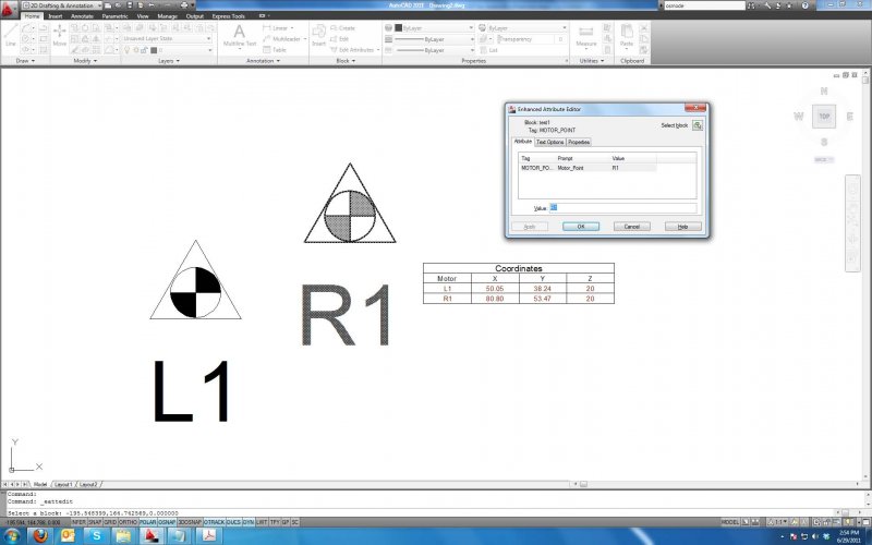

I have multiple attributed blocks which I would like to create a lisp to create a table of the xyz coordinates of the base point of each the block so that correspond to the "value" (name/title) of the block. Something similar to the attachment.
Thanks for any guidance you can provide!

(defun C:EXT ()
 (command "_EATTEXT")

you can add or delete blocks and with 2 click update your table
