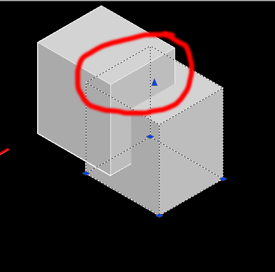

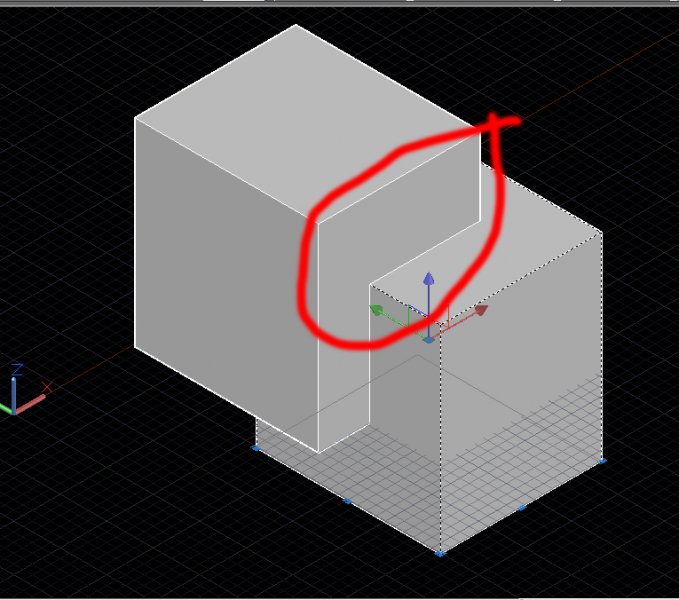

i have a problem here, i have two object intersect each other ,when i select one of the object the edges that in the intersect part is hidden! how can i make them visible?
i have this problem in autocad 2012
in autocad 2011 there was no problem

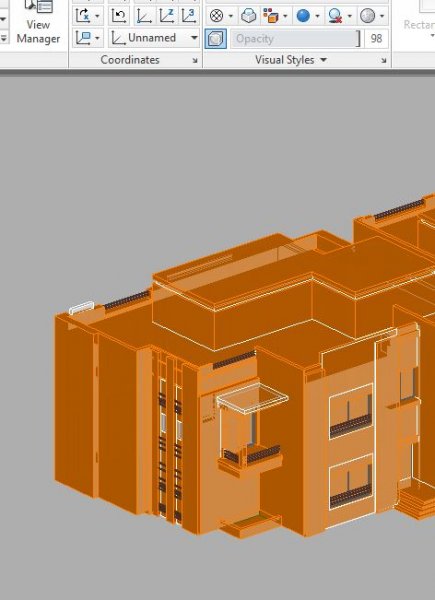

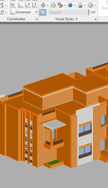

I'm pretty sure that's the expected effect in "Shaded with Edges" visual style. Try X-Ray visual style or decrease the opacity on the View Tab / Visual Styles ribbon panel (VSFACEOPACITY)

Could you give a screen capture of what shows in 2011 when you select one of the objects. Then another to show how 2012 is different. Perhaps it's just a setting.
Your visual style seems to be different between the 2. The 1st has a visual style of "Shaded with edges" in 2011. The 2nd seems to be something like "Shades of grey". Also you might need to check if the performance tuning is the same on the 2 versions (e.g. something like discard back-faces).

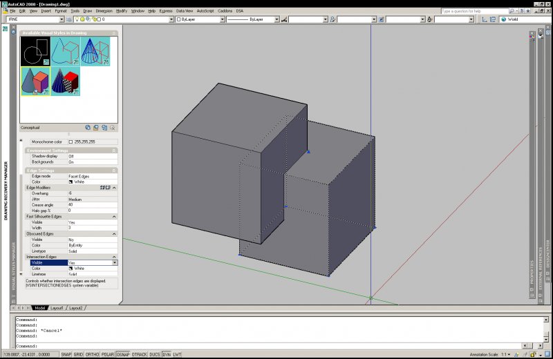

Or it could be the XRay visual style with a very close to 100 (not on 100) transparency or "Realistic" with VSEdges set to Facet/Isolines. Open the View tab in the ribbon and play around with the preset visual styles, then adjust the VSEdges (button just under the VS drop-down - looks like a ball with longitude lines on it).
Or open the VisualStyles palette (just type that word, or click the down-right arrow of the VisualStyles group on the view panel of the ribbon, or Menubar: View-->Visual Styles-->Visual Style Manager...). Then adjust stuff for the "standard" styles to suit your need. E.g. to get those cutting lines to show: about 7th from bottom is the Intersection Lines --> Show (Yes/No).

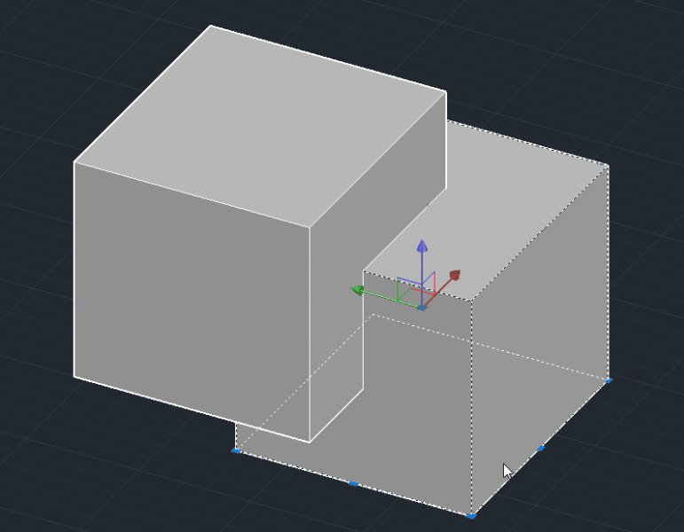

Yeah, I'm not even convinced that the behavior the OP is trying to replicate is from 2011 ... (notice that there are no mid-grips on the edges of the selected solid 2nd screencap).

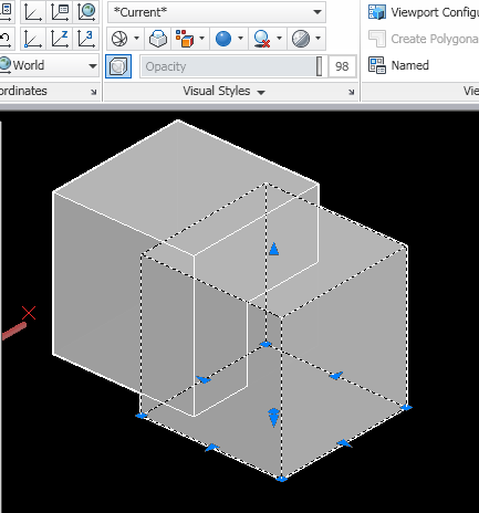

This is 2011 Shaded with Edges + VSFACEOPACITY = 98

Yes and selecting using VS "Shade with edges" makes a slightly different highlight on my Vanilla 2011 as well:
Notice that the base of the bottom cube is also highlighted. But that might be due to the way I created it (i.e. rectangle & extrude).
with my thanks for all the replies,but no one solve my solution,need more help and more answers,(please try to make two boxes like what i did on autocad 2012 and see what i mean):unsure::unsure:
Have you actually tried turning on Opacity control? I just installed 2012 and as far as I can tell, the visual styles are the same as they were in 2011.
I do not believe your 2nd screencap in Post #13 is from AutoCAD2011 because of the absence of midpoint grips on the selected 3D solid. Even if it is 2011, that IS NOT the default "Shaded with Edges" Visual style.
I did a video that toggles back and forth between AutoCAD 2012 and each of your screencaps showing how to achieve each effect. Beyond that, perhaps change VSOBSCUREDEDGES and/or VSOCCLUDEDEDGES ?
http://www.screencast.com/t/O1Z9hl1DAzu
Why do i have to change opacity in 2012 ,while in 2011 i do not touch the opacity and get the result i want .when i change the opacity in 2012 for objects with differant color ,it looks very bad
Exactly. If you want the intersection edges to display you need to have a VS set to something like "Shade with edges" or turn on the "Cutting edges" in the VisualStyles palette. In both 2011 & 2012 (when you do this) only the visible edges of a solid gets highlighted when you select it (except for that bottom - which is the originating entity, i.e. closed polyline).
If you need all the edges to highlight then you need to turn on opacity as nestly showed you. You could create your own new visual style (say using the XRay one) and then modify it to suit your needs exactly (cutting edges, obscured edges, opacity, etc.). Then you can simply select that one to have it displayed - no need to adjust settings every time.
BTW, that 2nd capture in post #13 looks a lot more like 2008:
