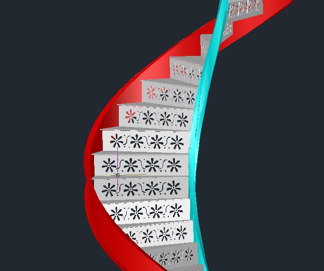

Bill Tillman Posted July 3, 2011 Posted July 3, 2011 I am once again trying to get the hang of drawing a 3D spiral staircase and cannot seem to figure out the SWEEP command properly. I have a channel, or a rectangular tube shape which I want to use for the stringers. If I use a round tube, like when I do the handrail, there is no trouble. But when I use a channel or rectangular tube shape the SWEEP command causes the shape to bank and I end up with an unuseable shape. In the attached drawing (ACAD-2007 format) I have shown a SPLINE which indicates the path I want the outside stringer to follow. Spiral Stair(02).dwg Quote
Jack_O'neill Posted July 3, 2011 Posted July 3, 2011 Is this closer to what you wanted it to do? u.dwg Quote
SEANT Posted July 3, 2011 Posted July 3, 2011 This is another method. Copy Loft Thicken OffsetFace Stringer.dwg Quote
Jack_O'neill Posted July 3, 2011 Posted July 3, 2011 Guess I could have said how I did that...stayed up too late last night, and not enough caffiene this morning yet. Seant's way may be closer to what you wanted, Bill. I took your rectangle, copied it to the top and swept it down the path with a 45° twist angle. Quote

Bill Tillman Posted July 3, 2011 Author Posted July 3, 2011 (edited) Can you give a little more detail on your procedures SEANT... Thanks KC Yes, what kencaz said...that looks pretty cool. I think I figured out a method on my own, although it's a tedious process of copying a section of the channel at each nosing location and then use LOFT to extrude the shape. I still have some fine tuning to do with this but at least it get's me in the ballpark. Edited July 3, 2011 by Bill Tillman Quote
SEANT Posted July 3, 2011 Posted July 3, 2011 Sorry, I was pressed for time and left a rather vague description. I copied the helix spline 10” down to the bottom of the rectangular profile. I lofted the two Helix/Splines, accepting the “Cross Sections Only” option. That created a surface entity (I left a copy of that surface in the dwg file – see at the middle of the solid). The Rectangular profile was 2” wide, but because of the orientation of the surface at the middle, I thickened 1”, and SolidEdit-OffsetFace the other inch. Cool stairs, by the way. Quote

kencaz Posted July 4, 2011 Posted July 4, 2011 Sorry, I was pressed for time and left a rather vague description. I copied the helix spline 10” down to the bottom of the rectangular profile. I lofted the two Helix/Splines, accepting the “Cross Sections Only” option. That created a surface entity (I left a copy of that surface in the dwg file – see at the middle of the solid). The Rectangular profile was 2” wide, but because of the orientation of the surface at the middle, I thickened 1”, and SolidEdit-OffsetFace the other inch. Cool stairs, by the way. Thanks SEANT, That seems like a better method then lofting profiles... KC Quote
