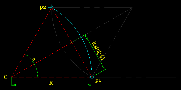

(defun LM:Bulge->Arc ( p1 p2 bulg / cen ang rad )
 (setq ang (* 2.0 (atan bulg))
       rad (/ (distance p1 p2) (* 2.0 (sin ang)))
       cen (polar p1 (+ (- (/ pi 2.) ang) (angle p1 p2)) rad)
 (if (minusp bulg)
   (list cen (angle cen p2) (angle cen p1) (abs rad))
   (list cen (angle cen p1) (angle cen p2) (abs rad))
For the explanation of the Bulge to Arc function, consider this relationship and rearrange for R.
Also note that a negative bulge indicates a clockwise arc, so the arc angles must be reversed in this case since an Arc is always defined anticlockwise.
For the explanation of the Arc to Bulge function, this is using the fact that the bulge of a Polyline Arc is the tangent of a quarter of the included angle.
