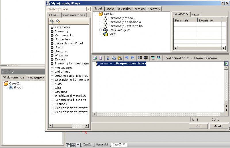

Here Are some screens

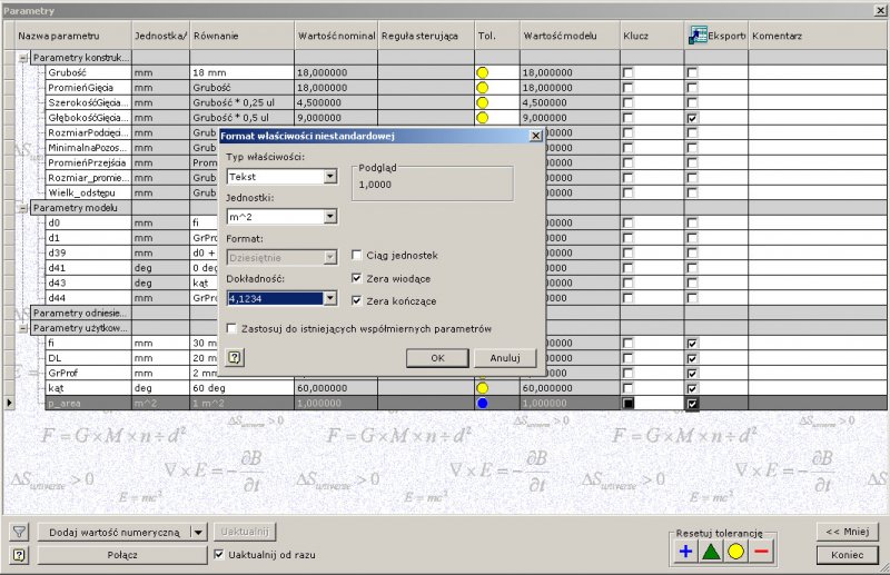

1. In the parts/assembly file (template file) I created a custom parameter of desired name, in my case "p_area" and I defined it's units to what I needed, that is square meters, then I checked the Export box and defined more options from the right click custom properities of that parameter.
2. then I created a simple iLogic rule named "iProps" You ofcourse can make it an external rule ofc.
p_area = iProperities.Area
basically it transfers the area value from parts iProperities into my custom parametr in (fx) parts parametes list

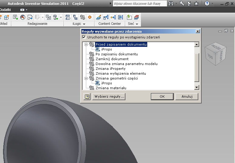

3. then I defined the rule execution triggers, whenever the geometry changed the rule would recalculate the area value, so it would be always accurate, its in Management tab (at least that's the direct translation of the tab from Polish) iLogic section. I checked the before save trigger too, just to be sure.

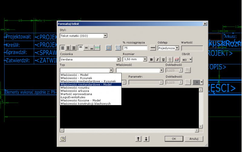

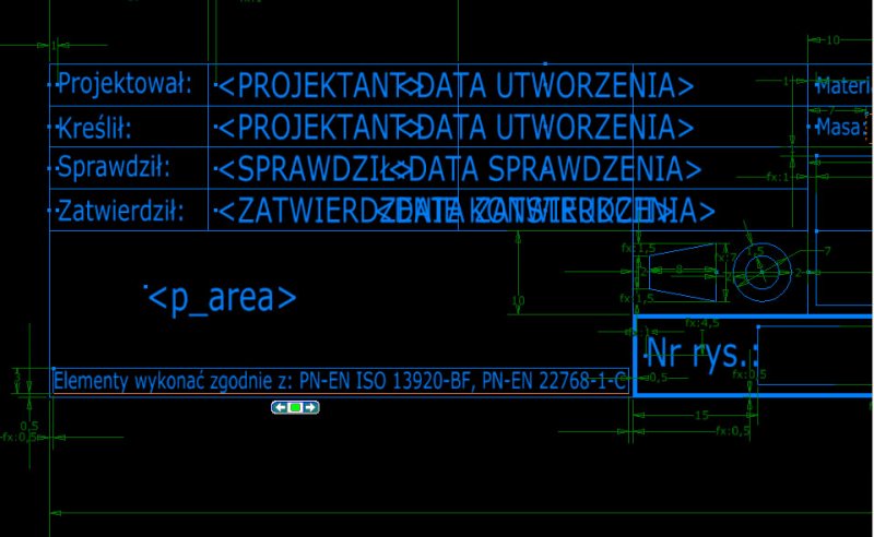

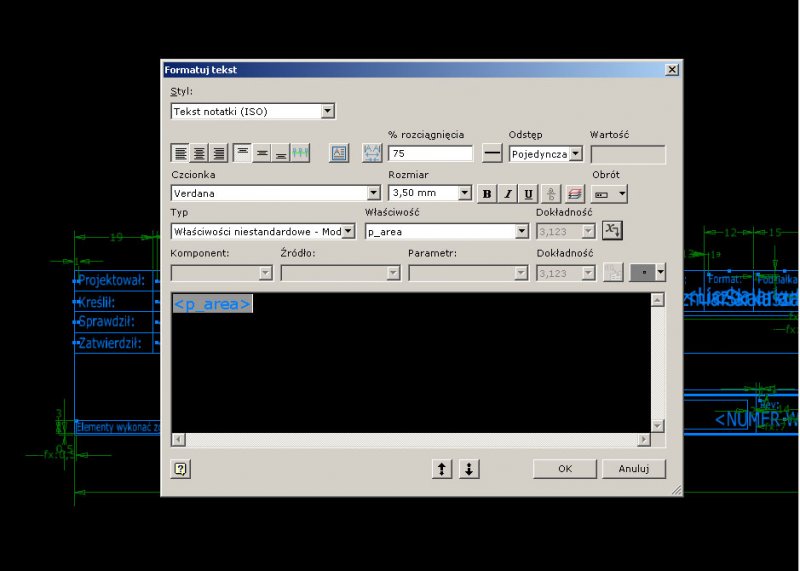

5. I opened the table box Definitions (sketch) and added a text field, then I chose in the TYPE dropdown menu list the "Custom properities - Model" (at least thats the direct translation) and in the nest dropdown menu i chose my custom parameter
6. Closed the Table Box Editor, remooved the Base View and saved the IDW as a template.

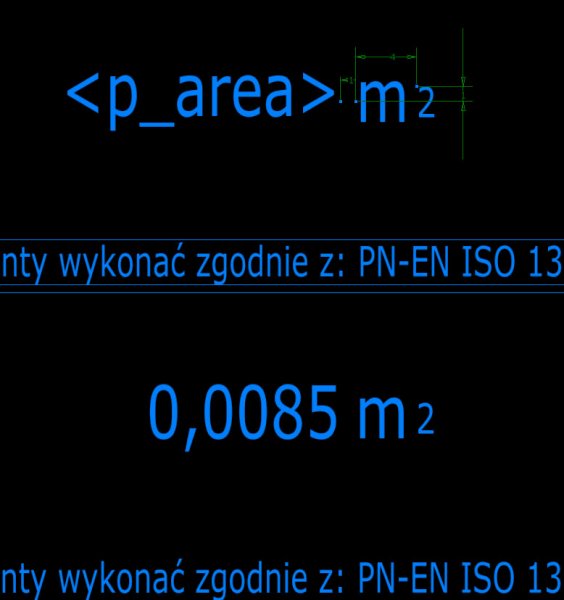

This method gives You control of units display of the particular parameter in model/assenbly file, I turned it off becouse I dont like the "^" mark so I manually added m2 (the 2 as a uppercase),
Unfortunately You have to manually add the properity "p_area" to custom properity list(fx) and set the "want to be" units, ofcourse if You can code that in iLogic, You can make it by iLogic, I can't :)
