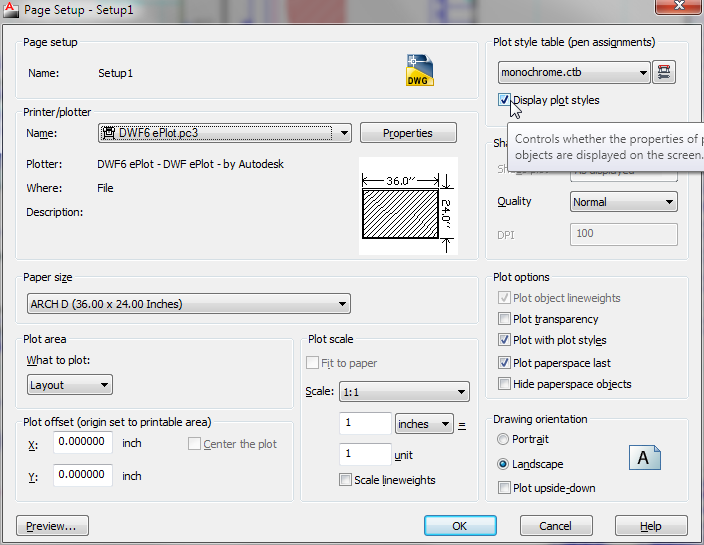

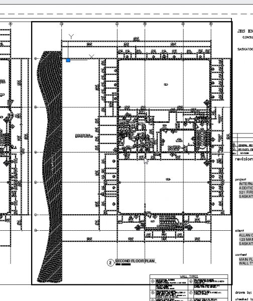

irneb Posted July 9, 2011 Posted July 9, 2011 Firstly the "trick" is to use a paperspace viewport and set that tab's Page Setup to a "special type". You need to turn on the "Display Plot Styles" check in the "Page Setup" dialog. After that turn on LineWeights (if your CTB/STB has differing pen widths) (the LWeight system variable). Finally go inside the viewport, select the linework and press Ctrl+C to copy it to clipboard. Next open Word (or in my case LibreOffice Writer) and paste there. You can paste special to have it linked to the DWG file (as if it's an xref to that DWG) or you can simply paste normally as an embedded OLE object. Or you can have it converted to EMF metafile as I've done in the example. However, you've got one problem: Scaling! Word / Writer is not meant for accuracy, these images tend to have a mind of their own when you paste them. Though that you'd probably have as an issue no matter what you do - it's a "feature" of these word-processing programs. AFAIK this method is the closest to making a decent job of it - without requiring lots of extra programs. Quote
