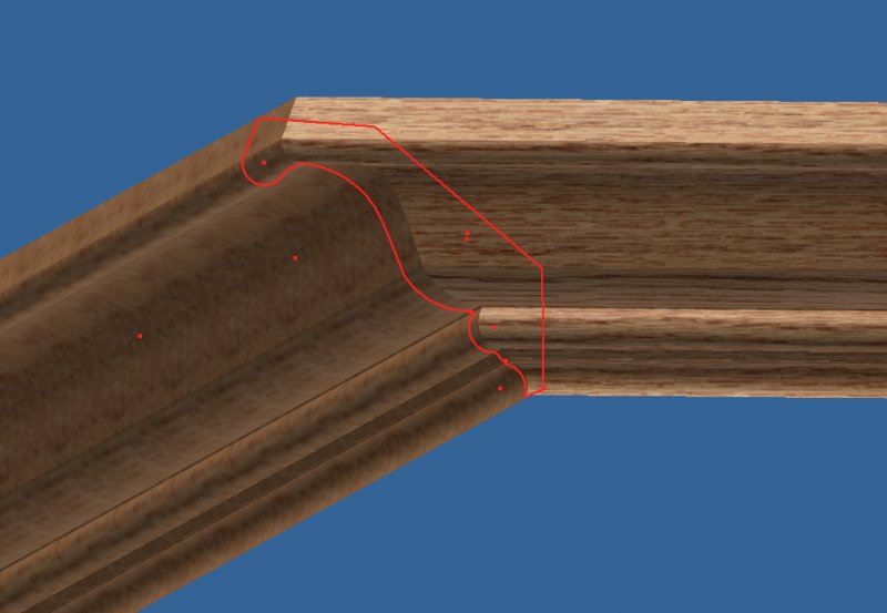

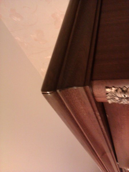

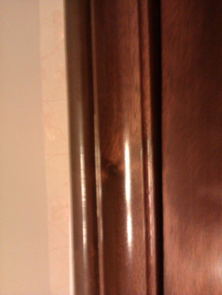

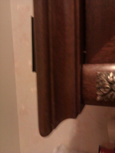

I try to represent a box with inventor fusion. My difficulties are on the outline. My objective is to have the same outline of the pictures. If someone can help me to do it?

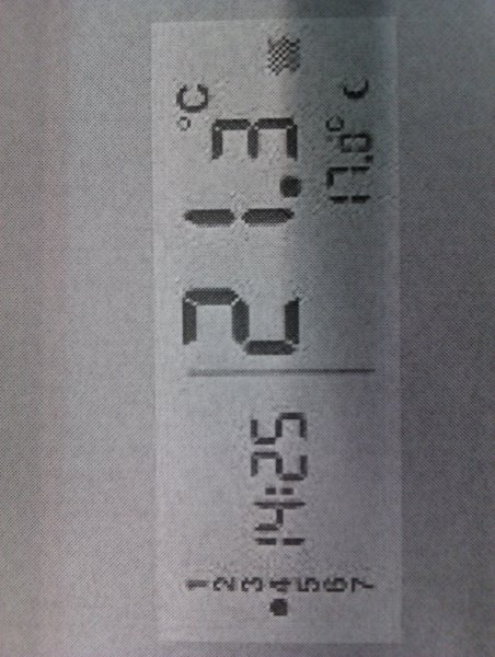

Is there a possibility to write the numbers like on the picture on Inventor or is there another way?

Use the "Sweep" function. Make your moulding profile sketch perpendicular to your sweep path.
Use "Decal" on an offset plane to for the number image.
