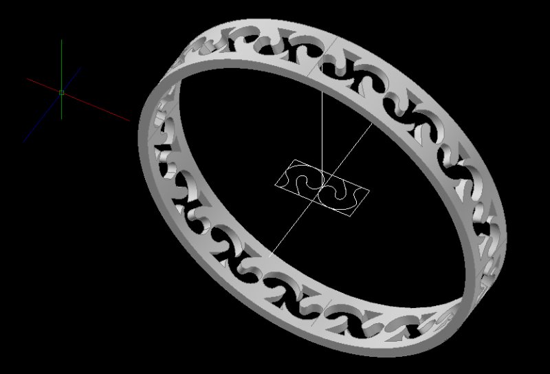

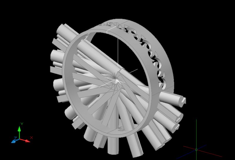

Well, You can take a pattern and using a polar array give a pretty good representation of a revolved pattern. With more time you can get some pretty good results. A 3D printer may give you a good mold pattern for your casting, however, You could still cast maybe (2) straight ring halves and roll them. The later may save you a lot of time...

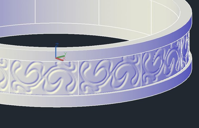

That looks like a good method. If “AutoCAD mac” has any 3d capabilities, that should be part of the arsenal.
Here is the work of a prototype add-on. I had to keep the relief rather coarse to stay within the file size limit. I doubt, though, that the .NET code would work in the mac version.
Relief.zip
