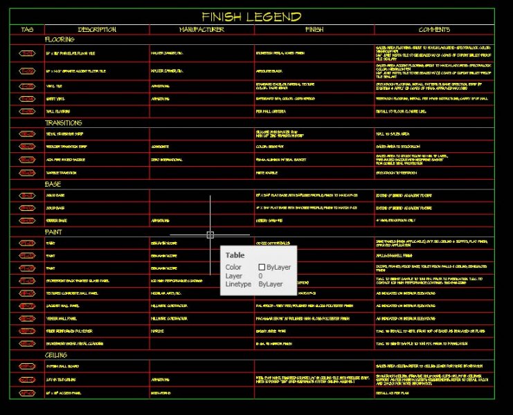

I have a little issue I’ve never encountered regarding the border color not retained by the cells. I’ve created a table style to use throughout our drawing set. I have merged cells for the table title, as well as section titles in the table. I have set colors associated to the borders. All is fine, until I click in any cell to make a change, then all the merged cells lose some or all colors associated to the table (see below). I’ve even tried locking the format, but it still happens. Has anyone ever encountered this issue? Thanks
-Brian
Quit the drawing. Close AutoCAD. Reopen AutoCAD and load the drawing. Did the colors revert back? Yes/No?
Thanks but no dice. Whenever I click in a cell, the colors of the merged rows revert, mostly to no border, or white. I unmerged, set the colors, then re-merged, thinking maybe there was Maybe there was a property mixed up in there. I locked the format, I’ve locked the content, and they always change back.
This happened to me once. I set the border style in the table style, but then I didn't press the button to apply it to a border configuration. I went crazy trying to figure out why the colors never changed.
