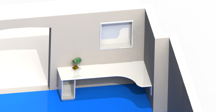

So here it is - my new desk in the new room
It's so cool to see it before you build it.
So with this preview there is really no need for real view.
But preview and end rendering is still faster with a Quadro - or?
Nice work.
