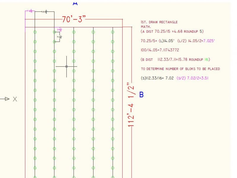

In this thread hopefully there will be a final lisp that I want and need
1st I need some way of measuring the area lets say rectangle.
(defun c:xxx (/ pt1 pt2 pt3 pt4 ltbay1 bay num_br)
(setq pt1 (getpoint "/nTop:"))
(setq pt2 (getcorner "/nBottom" pt1))
(setq pt3 (list (nth 0 pt2)(nth 1 pt1)))
(setq pt4 (list (nth 0 pt1)(nth 1 pt2)))
(command "_rectang" pt1 pt2)  ;;;; i can live without actually drawing it but at this stage of lisp i want it there
(setq ltbay1 (rtos (- (nth 0 pt3) (nth 0 pt1)) 4 1)) ;; i want to measure distance of one side of rectangle
(setq num_br (1+ (fix (/ ltbay1 (rtos 15 4 1)))))
 (print num_br)
My error is measuring a "distance" by substracting x coordinate of one point from another,i dont know about other ways of getting that distance i added rtos when i saw the problem doesnt help
I also forsee a problem for specifying rectangle in different quadrants of xy axis
but for now i do it simpliest way
I hope to have comments suggestions

You setq ltbay1 as a string in line 1, and string can't be use in math / in line 2 Edited by ketxu
I'm not sure I understand why you are dividing the linear distance along one side (the X-Axis?) by 15, however, here is one way to get the area of the rectangle being drawn:

I'm not sure I understand why you are dividing the linear distance along one side (the X-Axis?) by 15, .....
By Dividin x axis by 15 i will get the points of projection from one side of a rectangle( x-axes) to next x-axis bottom of rectangle, but i realized that
(setq ltbay1 (- (nth 0 pt3) (nth 0 pt1))) outputs one type of units and I need "feet" to divide by 15 ft,hence I dont know when is a good time to convert my numbers to feet...because i have a bit more math to do and i dont want to do conversions repeatedly
No worries... if you could post the rest of the code, or clarify what additional calculations you require, perhaps myself (or someone smarter) would be able to help suggest a more efficient way of doing what you need?

This is the main idea of lisp
I saw statement (if (and.... please easy example of it
Why not use DIVIDE or MEASURE commands.
Divide and measure doesn't allow for the offset on edges that may be needed. This is a new post for the same subject that has been extensively commented on already.
