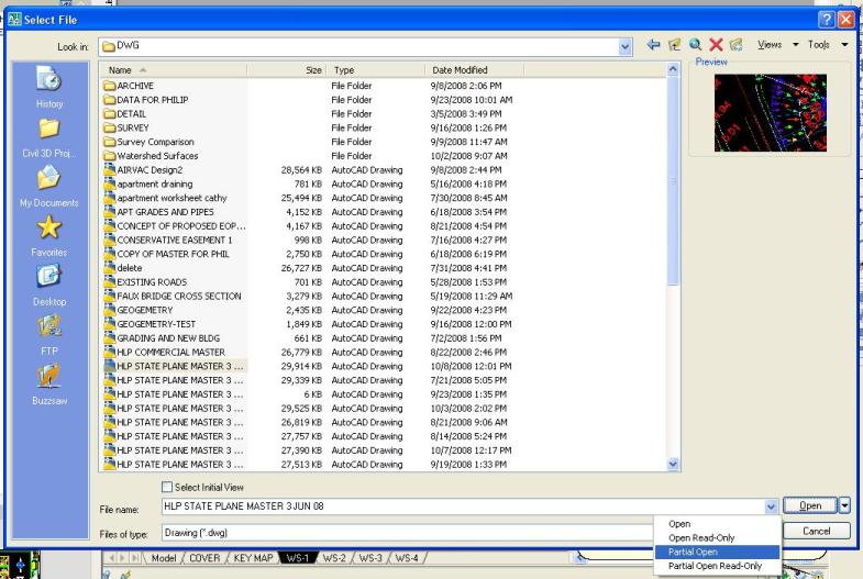

Kelly Posted October 8, 2008 Posted October 8, 2008 I cannot get some of my files to open. When the files would open I purged and audited. I needed to save the entire file as another name and now... I cannot get either of the files(with new name or old name) to open. Note: I have used xrefs in these files and the file paths are renamed accordingly (old and new). I have deleted any backup files that may be corrupted, any suggestions as to how I can correct this would be appreciated. Thanks Quote
Tiger Posted October 8, 2008 Posted October 8, 2008 What does AutoCAD say when you try to open them? Have you tried opening them through Recover (File - Drawing Utilities - recover)? Have you saved them with another version of AutoCAD? Quote
Kelly Posted October 8, 2008 Author Posted October 8, 2008 Thanks for the reply, I am not getting an error message at all. When I try to open it freezes my computer and brings up a white screen in CAD, then CAD goes to a " AutoCAD is not responding" mode. In a recovery it also locks up my computer after the recovery has run and i get a "runtime error Program:C... R6025-pure virtual function call" The image will show once I have opened the file even when in "Not respond" however the model and paper space tabs do not show up, it opens to 99% then freezes. Quote

hotrodz0321 Posted October 8, 2008 Posted October 8, 2008 have you tried to do a "partial open"? Quote

Kelly Posted October 8, 2008 Author Posted October 8, 2008 I did try the partial open, which worked if I did not load xrefs. I opened reloaded all xrefs in drawing and resaved. However, when I try to reopen the file after a partial open, it does the same thing... freezes CAD...after doing a partial open and rereferencing the xrefs, what would u suggest I do to ensure it opens the next time? Quote
