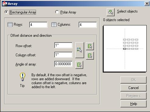

CalypsoArt Posted July 21, 2011 Posted July 21, 2011 In 2012 when I select the array command I no longer get the dialoge box and have top enter parameters @ the command line. How do I get commands to default to theor option dialogue boxes. Quote
rkent Posted July 21, 2011 Posted July 21, 2011 There is no longer a dialog box for array. Using -Array will get you a simplified command line version. Users have reported replacing two files from 2011 with 2012 files to get a dialog back. The problem with that is you will miss out on the powerful new features 2012 array brings to the table. The command line is easy and you will see on screen dynamically what you are inputing. Quote

ReMark Posted July 22, 2011 Posted July 22, 2011 Strange that there is no way to get the classic ARRAY dialog box back. They changed the HATCH command as well yet, if I am not mistaken, there is a way to bring the old dialog box back for this command. Wonder why? Quote
nestly Posted July 22, 2011 Posted July 22, 2011 Yeah, I've only played with 2012 a little bit, and while the new associative arrays are cool, I don't like not having the familar array dialog for regular arrays. Some smart person needs to figure out how use the 2011 arx files in conjunction with the new 2012 array arx's Quote

nestly Posted July 22, 2011 Posted July 22, 2011 Yeah, paying for a 3rd party add-on that's new and fancy is one way to go, but I think what most users would really like is to have access to the familiar and efficient basic array dialog. Quote
