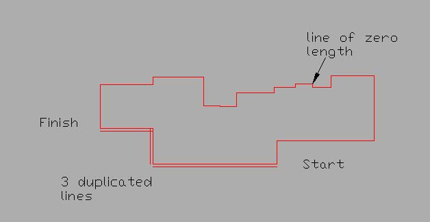

eldon Posted July 25, 2011 Posted July 25, 2011 If you List the Polyline, it says that it is Open, so the area shown with the Area command is not valid. You could explode it, and then see where the doubling up of lines occurs. But if that is not something you want to do, the easiest way to get an area is to use Bpoly, and one sees that the area is 3398.2124 sq ft. Quote

eldon Posted July 25, 2011 Posted July 25, 2011 You will also have to make sure that you only have single lines, and that the start point and finish point are at the same point! As the picture shows, there was an extra line of zero length at one corner, and the first (or last) three lines were duplicated. Quote

eldon Posted July 25, 2011 Posted July 25, 2011 If you close your polyline, a line is drawn connecting the Start of the Polyline and the end. It does not delete duplicate lines. Even if you explode it, Pedit tries to use all the lines that have common end points. It is much safer to make sure lines are not duplicated, or to use the Bpoly command. In this situation, I might explode the polyline, then use Bpoly to make a proper closed polyline, and erase all the lines that made up the original polyline. Quote
danellis Posted July 26, 2011 Posted July 26, 2011 You might want to try the OVERKILL command. In theory this deletes duplicate lins (not sure about 0-length ones). dJE Quote
