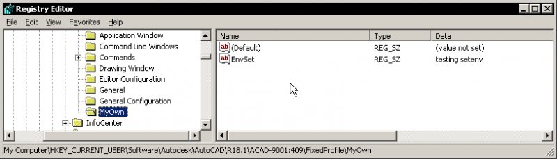

If you mean the environment variables, you can see them all in the registry. Open RegEdit (type RegEdit into the search box on Vist/Win7's start menu, or type RegEdit into XP's Run.. dialog). Then browse to the registry key: HKEY_CURRENT_USER\Software\Autodesk\AutoCAD ... under which would be listed all the versions installed on your PC (including Verticals). E.g. my ACA 2011's is: HKEY_CURRENT_USER\Software\Autodesk\AutoCAD\R18.1\ACAD-9004:409, while my Vanilla 2011 is HKEY_CURRENT_USER\Software\Autodesk\AutoCAD\R18.1\ACAD-9001:409. For 2012 it would be under the R18.2 folder and then a similar code for the vertical.
Under this, most of the standard environment variables are contained in: HKEY_CURRENT_USER\Software\Autodesk\AutoCAD\R18.1\ACAD-9001:409\Profiles\>\General
There are some others under: HKEY_CURRENT_USER\Software\Autodesk\AutoCAD\R18.1\ACAD-9001:409\FixedProfile\General. Which is also where any custome environment variables you create will get saved. E.g. issuing this at AutoCad's command line:
(setenv "MyOwn\\EnvSet" "testing setenv")
Will create a new folder under the FixedProfile folder named MyOwn and a value in there named EnvSet with its contents as "testing setenv". See this screen capture:
As a sample (the one most commonly used): (getenv "ACAD") gets the support folders. This is actually the ACAD value under: HKEY_CURRENT_USER\Software\Autodesk\AutoCAD\R18.1\ACAD-9001:409\Profiles\>\General

Thank you very much for your detailed post the regedit was the part I was after (getenv "ACAD")
