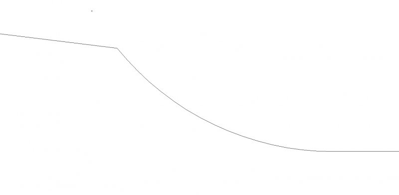

The question. Some of the drawings I am working from have things on the labelled as being "UNDER RAD" or "OVER RAD" and I have almost Googled myself senseless trying to find out what this means and how to do the necessary calculations to get the drawing right?
Can anyone explain these terms to me please? Or point me at a website that will explain them?

The blueprint I was drawing from had a label pointing at the end of the angled line indicating that I had to draw a R4 curve between the angled line and the horizontal line "UNDER RAD at Diameter 600". I did it in the end by trial and error - what I am looking for is the mathematical / non-trial and error of doing what I had to do.

UNDER and OVER RAD are old terms of convex and concave RADIUS tolerance features and really are no longer really used in modern geometric dimensioning and tolerancing. (When I say modern, the last 10 years..) The modern or standard BSEN or ISO standard is a simple R with a numerical indicator of the size and tolerance, or a min max dimension. It difficult to explain when youre using terminology that is deprecated that long ago in the drawing world, and google will only recognise the modern terminology. if you do have any such problem understanding old or foreign GD&T referencing in CAD when learning, please do PM me and ill take you through any Geometric Dimensioning and Tolerancing Questions you may have....
