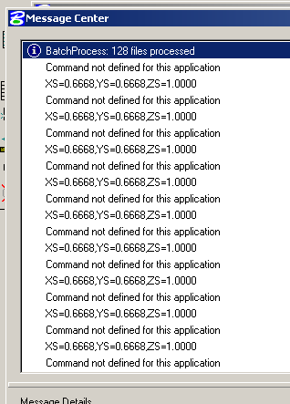

Fastdraft Posted August 1, 2011 Author Posted August 1, 2011 The cell library is not read only and the models are not locked, I am puzzled my script file that I am using is shown below. and it tells me that the process ran but when i go back and messure the a component it is the same size as it was before I ran the batch process. Quote
Fastdraft Posted August 1, 2011 Author Posted August 1, 2011 I just tired it again and then looked at the message getting after ran the batch process Quote
envisioncad Posted August 1, 2011 Posted August 1, 2011 Fastdraft, go back to my first post. MicroStation does not know what the keyin "scale" is? You need to think of a script file as a list of steps that you would do in the program. 1. You need to set the scale factor "as=8" 2. You need to select the elements "choose all" 3. Then pick the tool "scale icon" 4. Then you accept the command "xy=0,0" 5. Dont forget to clear your selection set "choose none" 6. Set the scale factor back to 1 "as=1" 7. Finally Save your Settings "filedesign" HTH, Bob Mecham Quote
