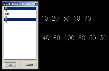

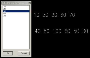

This is a strange request from a co-worker:
Say you have a text "15 LF OF 2"X6" HORIZONTAL SUPPORT"
and another text "20 LF OF 2"X10" HORIZONTAL AND VERTICAL SUPPORT",
if you want to copy the words "AND VERTICAL" onto the mid-sentence of the first text
to get "15 LF OF 2"X6" HORIZONTAL AND VERTICAL SUPPORT", how would go about doing it?
Double click, cut and paste?
_find?
what if
1st text "10 20 30 60 70"
2nd text "40 80 100 60 50 30"
grab "40" and "50" from the 2nd text to get "10 20 30 40 50 60 70"
or you use this:
(defun c:MidSentence (/ CDiaStr ListBoxDia CollectStr

Still need a lot of work :), but its fun coding it :D
It funny code ^^ But i think Ctrl C and Ctrl V is faster, except text to grab discontinuous ^^ Thank you !

dear sir eror
Command: TEST
Select text to replace first word: ; error: no function definition:
AT:TEXTSTRING
dear sir eror
added missing subroutine, but THIS IS NOT 'COMPLETED CODE', it's an abandoned proof of concept. I posted it for the benefit of pBe digging through, if interested.
@alanjt : you use dos_proplist, and .....
arg. Download DosLib and anything else that's missing, I'll post.
I should have just pmed it to pBe.
I feel with you. :D
No way dude, I'm married. :P
:lol: Anyhoo.. found some useful bits on your code
Thanks Alanjt
PS: _Breakup and _reunion an inventive function name but somewhat appropriate. Nice Alanjt
Thanks Alanjt
Thanks and you're welcome. That's what I posted the code for, the rest is just to see how I used them.
Hope it helps.
