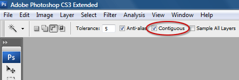

I am new to photoshop and I am looking to enhance my floor plans with photoshop. When I take a floor plan from cad (Just the line work) and make it into an EPS file, and then try selecting a single item with the pointer (not sure if that is the right name for it) - it looks like a magic wand - this selects the entire plan, resulting in the whole plan looking the same colour, or the same texture etc.
Is there any way to select one item, for example a plank of hard wood or the entire floor that i want to be the same, or select a single object (chair or sofa)?

When using the Magic Wand to make selections, you can control whether the selection is made from the whole drawing or from just the single area you are selecting. Check the "Contiguous" option to select a single area within your plan. You may also want to reduce the Tolerance for more accurate selection.

Though I haven't actually tried important a .eps into PS, I do know a good deal about the program. First off, the magic wand tool. If you're not familiar with it or haven't used it before it can be a tad confusing. What the magic wand does is select all pixels of the same or similar color within the canvas. You can adjust the tolerance level up to accept a broader range of colors into the selection, or down to narrow it. With tolerance at 1, it well select all pixels that are the exact same shade of black. With a tolerance of 50, it will also accept some dark grays or dark colors into this selection. The contiguous check box is used to determine if you want to select from the entire canvas (off), or only select pixels that are adjacent to where you click (on).
Again, not having important an .eps I'm not sure the best way to do it. But I have exported a .pdf from AutoCAD (using a print to .pdf driver) and imported that into Photoshop. Upon importing you choose the resolution, I usually go around 600 or so, you can always downsize it later. Depending on what you're making this Photoshop document for determines your resolution. If it's just appearing on a computer screen you really don't need any higher than 72, if it's going to be printed out as a draft, perhaps 100-200, high quality, 300, or very high quality, 600. Anyway, after you open the .pdf of your floor plan in Photoshop, it should be on it's own layer. If it is on a layer called "background", double click the layer in the layers window and click "ok" when the box opens up, changing details if you desire. This will turn the layer from a background layer (which is tied to the size of the canvas) to a free layer, able to be resized and manipulated as desired. First thing I would do is resize your floor plan how you want using the transform tool. (In the edit menu I believe). If you only want a specific portion of your floor plan there's a number of things you can do to eliminate the excess. You can simply use the eraser tool to eliminate what you don't want (probably the easiest), or you can use the polygon-lasso to draw a box around what you want, copy it, and paste it to a new layer. Layers can be turned on or off in Photoshop with the little icon that looks like an eye, much like in AutoCAD.
