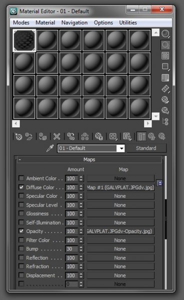

You need an opacity map. An opacity map is a greyscale image where black is transparent, white is opaque and shades of grey are seen as semi-transparent depending on how dark or light they are.

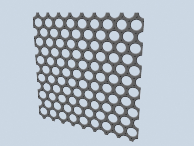

The first image below is your Diffuse map and the second image is the Opacity map. It goes in the 'Opacity' map slot, as shown in the third image below. The fourth image is a rendering of a flat plane with the materials applied.

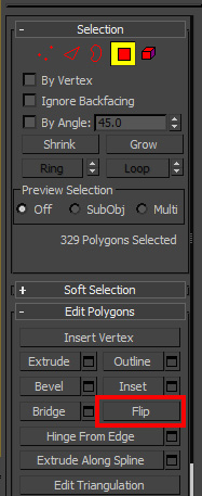

It sounds like your object is inside out. Use polygon selection mode, window select the entire object and click the Flip button.
Well, I dont think so, as soon as I fliped the object its turned into black and same invisible thing happened,about which I have said earlier.
