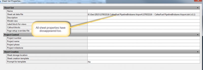

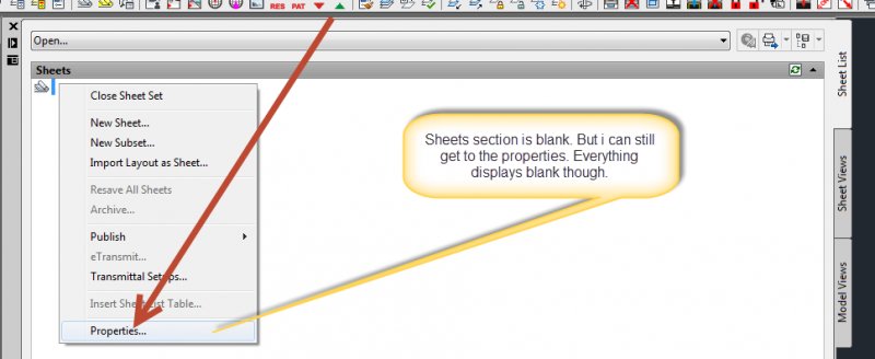

Hilarious, Civil 3d 2014. Same problem sort of... Sheetsets open but i cant use them or see the sheets etc.. see attached
Re-install from the windows control panel seems to fix the problem though.
