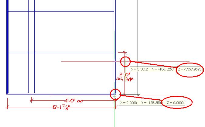

3 out of 4 dimension and the Mtext in the upper viewport were created on a plane 5357.9695 units below the node that attaches the dimension to the model. I didn't know this would necessarily cause a problem, but I expect that's not really where you want the dimensions to be anyway. I was able to resolve the issue by recreating those 4 objects (shown in red) on the same plane as the other dimension (shown in black)
Weird. I was able to actually grab and move the dimension into the correct plane and that worked just fine. I've noticed that sometimes it places the dimensions on a plane well behind the object, but I've never really thought much of it as long as the dimensions are visible. I don't know why it happens and it seems pretty random to me. Is there someway I can get get the dimensions to be in the correct plane without physically moving them after they're created?
I appreciate your help on this.
Dimensions are always created on the current XY plane, so I'd guess something like UCS > View, which is non-specific about defining the origin for the UCS could cause this to happen?
If I need to dimension in 3D, I usually create a different named UCS for each view that needs dimensioned, but there are certainly times when you don't want the dimension on the same plane as the objects. I probably never noticed this because I rarely plot hidden visual styles. I learned something new :)
