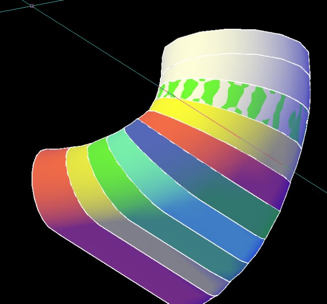

Those are some very strange solids. There are 11 solids that make up the funnel/duct, but when I select them all, I get only 19 grips, and I can't even snap to anything other than those grips, and really strange behavior when moving a face. What was the original geometry used to create the solids? Do you have a copy of the drawing before you lofted them?
http://screencast.com/t/KQGJpsuU
I made the different segments different colors so I could see what was going on. Part of the problem is that in that third band from the top, you got 2 solids occupying the same space at the same time. In real life that causes a nuclear explosion, according to Mr. Spock!
