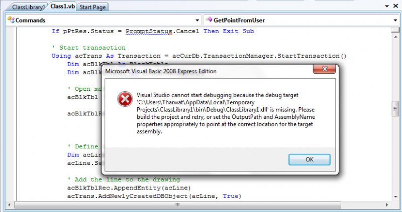

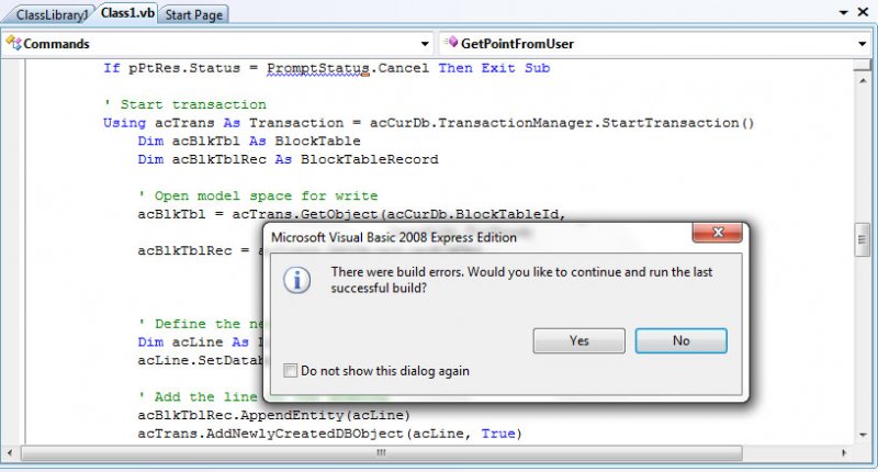

Thank you buddy ,
But here is the message that I always receive when pasting codes and hit the button Start Debugging to run the routine .
What was wrong with it please ?
In your project, rename the *.vb file (found in the Solution Explorer to the upper right) as "Commands.vb"
Paste the code into Commands.vb (which should be EMPTY), then save your project. At this point, you WILL see any errors listed in the error list toward the bottom of the IDE.
To confirm this, I have deleted everything from my personal Commands.vb and pasted in the code I posted above. I have zero errors at this time.
