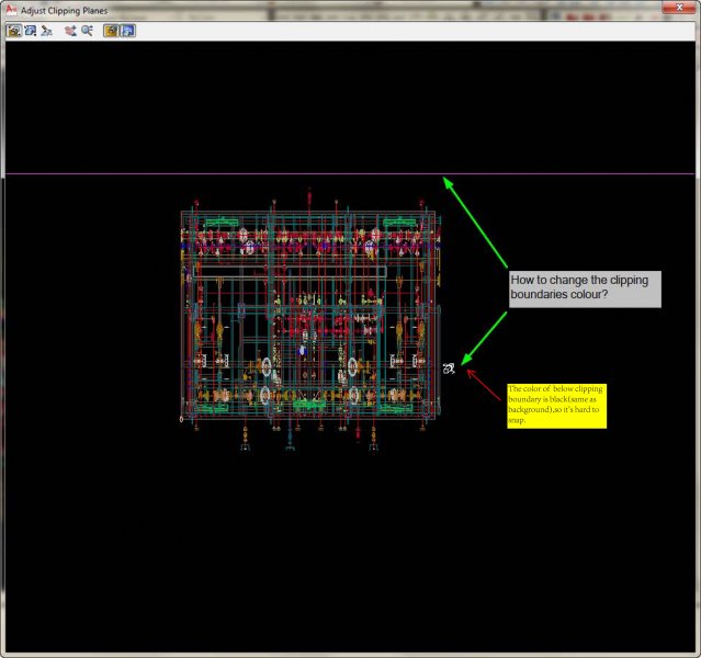

The problem I run into with 3DClip is that once my 3D model reaches a certain size I loose the visualization of my clipping boundaries. I can watch my viewport change as move the clipping plane but don't see a handy dandy line to show where exactly it is clipping.
Now if I could just get my front clipping plane to show up white, blue, yellow, or any color other than black given my black background! Anybody got any ideas there? Thanks! :?

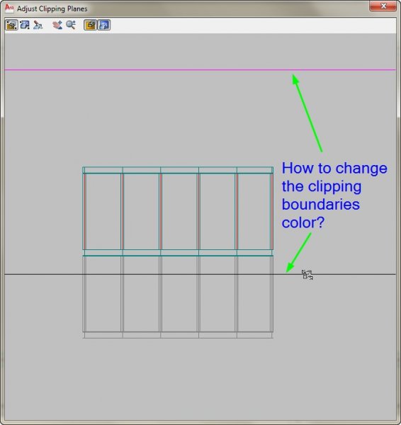

Anybody can tell me how to change the colour of clipping boundaries when use 3DCLIP in AutoCAD 2010? Thanks!

In AutoCad 2010, enter: "3dclip",
then pop up “Adjust clipping planes” which has two clipping boundaries, how to modify the boundaries color?

Try turning off hardware acceleration or change the background color for 3D Parallel Projection. It is a graphics card problem AFAIK.

Thank you very much! I know change the background color is ok, i aslo want to know whether the boundaries color can be changed?
