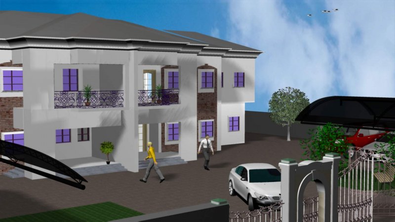

i modelled this twin duplex in autocad and tryin 2 render it in maxtwin duplex.jpg,thinking i we find my way thru it. as it seems i guess not!!!
my model look as it is floating in the sky .... i applied backgroung image of the sky....
how can i achieve i real background effect to these model???????????.can someone please give me a link to where i can download background images...and find tutorial on exterior rendering using mental ray.
i need a general comment on the rendering...... i dont know what to do next?????? can someone please help me.....

It just looks like you have the wrong type of image as your background. It's just a photo of clouds. You need something with a horizon. Something like the image below:

It looks like you have some issues with the faces of your model. You either have overlapping faces or the faces are not flat or something that is causing that strange shadow effect. You will need to investigate to determine what's causing that.

How are you lighting the scene? Are you using the daylight system? It doesn't look like you are.
I tried to find some good tutorials, but most of them are really bad. Check your Help files and the tutorials in the "Help" menu to find out about the daylight system.
