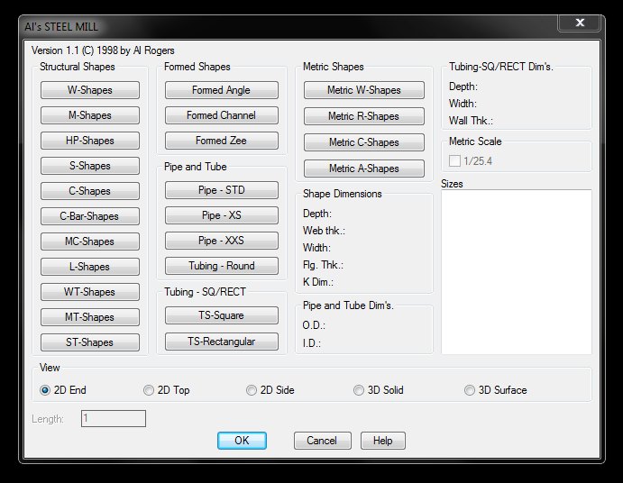

nestly Posted August 8, 2011 Posted August 8, 2011 Yeah, I'm pretty sure that had to be a lisp or add-on. I don't think AutoCAD ever had a complete built in set of steel shapes, and definitely not steel shapes that were drawn as polylines rather than inserted as blocks. I use Al's Steel Mill practically every day, and I highly recommend it. Demo --> http://screencast.com/t/0sVGk7cnPc Download --> http://cadtips.cadalyst.com/standard-blocks/steel-shapes-all-types-and-sizes Quote
boyan Posted June 5, 2013 Posted June 5, 2013 nestly, Thank you for the tip. I have downloaded the steel shape autolisp and did everything per the help.txt, but I can not start the program. current version - AutoCad 2011 - added the file path to the source files - loaded the application via tools/load application and get the following message "Al's STEEL MILL Loaded. Type STL to use." - when type STL nothing happens. I don't have any experience with autolisp routines, so I was wondering if you can help me out with the program. Thank you in advance. Quote
ReMark Posted June 5, 2013 Posted June 5, 2013 I have it working in 2013. Just installed it. You can load it but it does not run? Is this what you saw on your command line? Command: appload Stl.lsp successfully loaded. Is STL used as a keyboard shortcut for something else? Check your acad.pgp file. What is the path to the folder that contains the files? Quote
nestly Posted June 5, 2013 Posted June 5, 2013 Make sure the "Steel Mill" folder is listed in the support path, not just the folder where the Steel Mill folder resides. If still not working, open Windows Explorer and drag stl.lsp from the Steel Mill folder directly onto AutoCAD's drawing area, then see if STL will launch it. I vaguely recall having to load something (VBA enabler or something) on one of my computers to get Steel Mill to run, if you can't get it going, I'll try to dig that fix up. Quote
boyan Posted June 5, 2013 Posted June 5, 2013 Yes, it is installed, but it doesn't run. Just go it to work. I was linking to the parent folder, instead to the subfolder that retains the lsp file. edit: was typing my reply and didn't see that nestly suggested the same. Thank you to both. Quote
ReMark Posted June 5, 2013 Posted June 5, 2013 I kind of thought it might be a pathing error. Glad to hear you got it sorted out. Thanks for updating us. Quote
