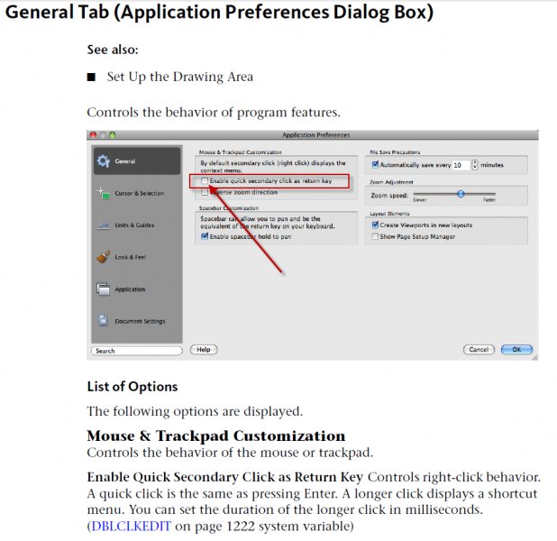

Have you tried the OPTIONS command? :unsure:
Ok, no I hadn't but now I have, it just gets me to the preferences page.
On a Mac, the options and the pref pane are the same thing and there is no option to disable menu in the drawing area there.
I was just wondering if it something the put on the mac version and how would I be able to get to it.
I feel like such a dork, that's it, thank you very much Renderman.
Trying to translate a pc tutorial onto the mac can be a little challenging, but I am getting there slowly.
Thank you for your help guys.
