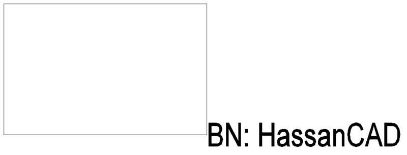

Here's a routine I found that lets you select a block and then place the name of the block as text.
Click HERE to see it in action
