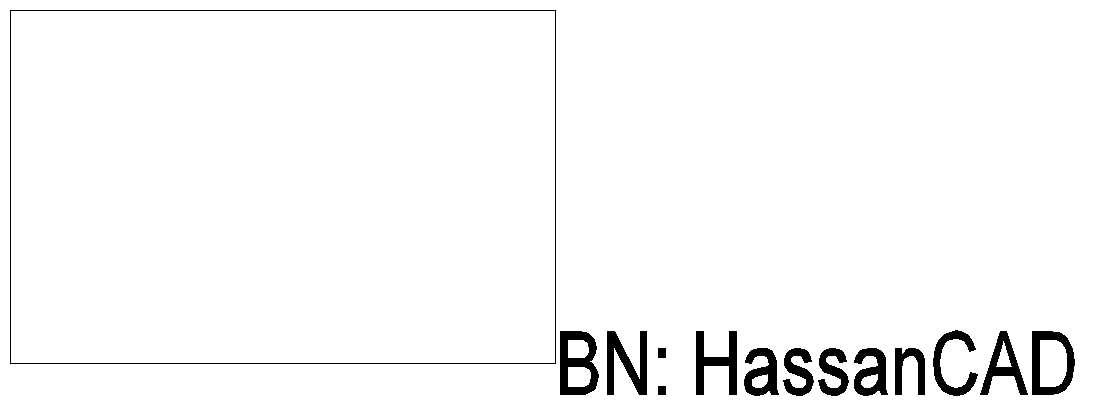

Hi everyone, this code for a block
How can I get multiple block name show on the block insertion point automotive?
