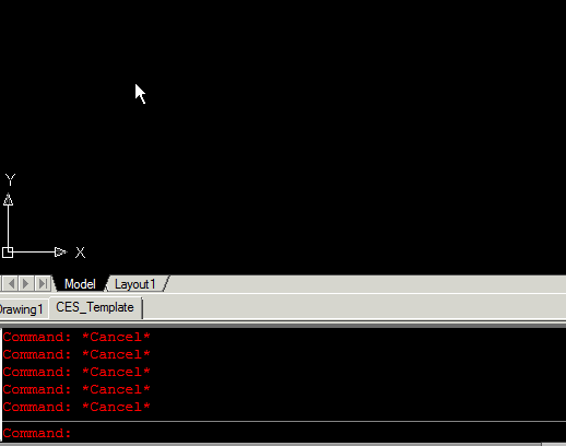

fathihvac Posted August 12, 2011 Author Posted August 12, 2011 (edited) Thanks for all My goal is to use autocad command _measuregeom (and precisely area) but i want to insert the result of this autocad command as text in the drawing area.Example : I have plan for offices restaurant and rooms. I want to calculate and put areas values for each of previous mentioned for later cooling load calcs.(Hvac) I hope you have understood what i want. May Be something like attached get area.lsp Edited August 12, 2011 by fathihvac Quote
pBe Posted August 13, 2011 Posted August 13, 2011 [ATTACH]29328[/ATTACH].................. (mapcar '(lambda (a b) (grdraw a b 7)) (setq lst (if (eq pt "Undo") (cdr lst) (cons pt lst) ) ) (cons (last lst) lst) ) Nicel Thanks Alanjt Nowhere near as elegant as Alan's-David You're too modest David Nice job Quote
pBe Posted August 13, 2011 Posted August 13, 2011 (edited) Thanks for allMy goal is to use autocad command _measuregeom (and precisely area) but i want to insert the result of this autocad command as text in the drawing area.Example : I have plan for offices restaurant and rooms. May Be something like attached So you meant points on screen and not the entity point in that case, something as simple as this would work (defun c:test (/ pt1 pt2 pt3 LxW str) (setq pt1 (getpoint "\nLower Left Corner:") pt3 (getcorner pt1 "\nLower Upper Rigbt Corner:")) (setq pt2 (list (car pt1) (cadr pt3) 0.0)) (setq LxW (list (distance pt1 pt2) (distance pt2 pt3))) (setq str (if (or (= (getvar "lunits") 3) (= (getvar "lunits") 4)) (strcat (rtos (/ (apply '* Lxw) 144) 2) " sq. ft.") (strcat (rtos (apply '* Lxw)) " m²") ) ) (command "_text" "_Justify" "_center" "_non" (mapcar (function (lambda (a b) (/ (+ a b) 2.))) pt1 pt3) (getvar 'TextSize) 0 str) ) I wanted to try the _measuregeom approach, unfortunately i dont have any idea what it does. you can use something like this right after the "_measuregeom" (defun c:test (/ str pt) (setq str (if (or (= (getvar "lunits") 3) (= (getvar "lunits") 4)) (strcat (rtos (/ (getvar "AREA") 144) 2) " sq. ft.") (strcat (getvar "AREA") " m²") ) ) (setq pt (getpoint "\n Select insertion point : ")) (command "_text" "_Justify" "_center" "_non" pt (getvar 'TextSize) 0 str) ) Reminder: (command "_text" "_Justify" "_center" "_non" pt (getvar 'TextSize) 0 str) if your current text style height is non zero, the line above will skip the text height prompt and take (getvar 'TextSize) as rotation and 0 as STR. This Edited August 13, 2011 by pBe Quote
