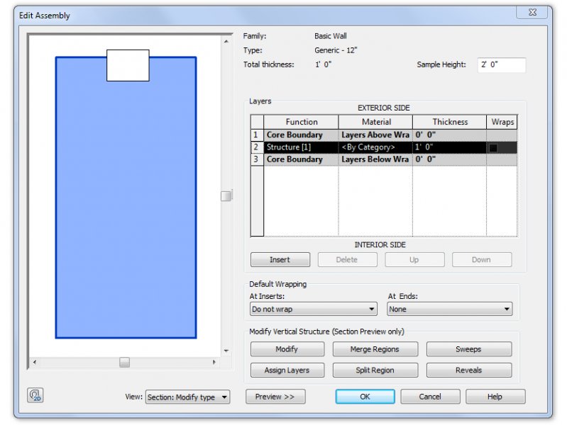

Found this on another blog:
For now, I've added a concrete beam (1'-4" w. x 1'-8" d.) along the lengths of my Retaining Wall Footings. Top of the beam is set at the bottom of the Ret. Wall Ftg. Because they are both of the same material, the section shows these two objects as joined
Use a wall reveal and cut out the key at the top of the footing. I draw the rebar in the 2D Section.reveal.jpg
