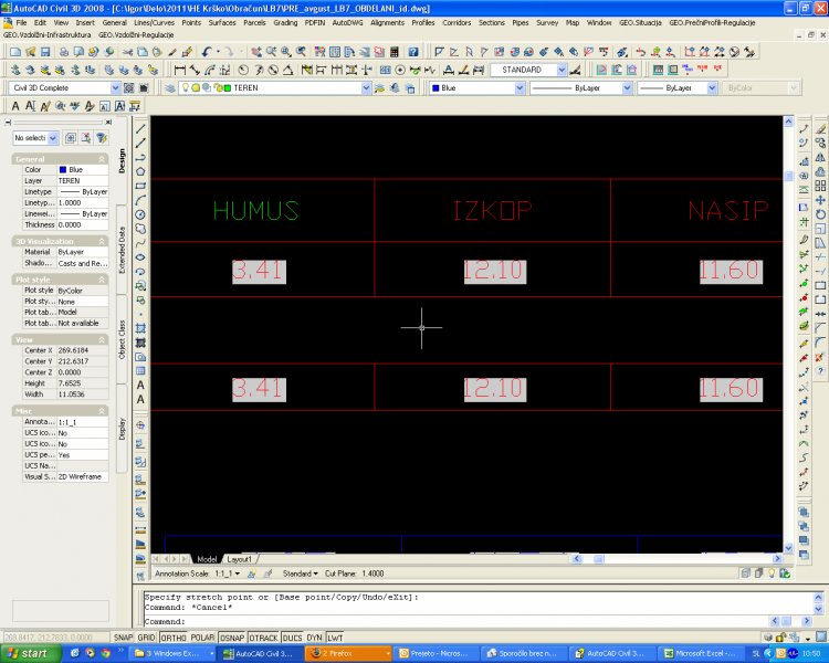

Hello, the sam question
one question about the tables in AutoCAD Civil ...
Is it possible to draw two or more tables and then make them together, as one of them to excel export, one can export. how the two tables do one without anything copied or copied from one to another
The number are dinamic in cells,...
