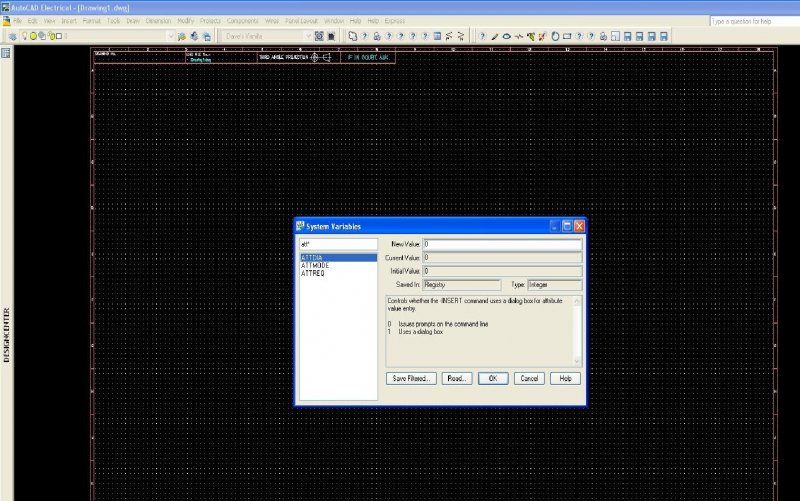

I think the ATTREQ is stored in the registry (you can check using the express tools variable editor tool - I'm not CADing yet today) so will apply to all future inserts until changed again. I'm not sure about ATTDIA, that may be on a drawing by drawing basis.
edit=====================
decided to start AutoCAD - both are stored in the registry so affect all drawings until changed.
