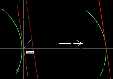

designerstuart Posted August 16, 2011 Posted August 16, 2011 okay this is so simple i'm sure but i'm a bit baffled..... i want to snap this line to where it would be at a tangent to the arc (as right), but as you see (left) when i hover with TAN snap it picks a tangent from the pick point, not from object's orientation. at the moment i construct a tangent by rotating a copy of my line by 90°, and snapping it to centre of the arc. then extend out past arc, where the intersection is now the point i originally wanted to pick. make sense? gotta be a better way! thx Quote

designerstuart Posted August 16, 2011 Author Posted August 16, 2011 thanks eldon, but have you tried this? i find it works the same as above, i.e. perpendicular to the base point, not the object. if i'm missing something, please do enlighten me! like i said, this should be really simple! Quote
Tyke Posted August 16, 2011 Posted August 16, 2011 Draw a construction line from the centre of the arc perpendicular to the line to be moved. Move the line to the intersection point of the construction line and the arc. I don't think it can be done without a construction line. Quote
designerstuart Posted August 16, 2011 Author Posted August 16, 2011 Draw a construction line from the centre of the arc perpendicular to the line to be moved.Move the line to the intersection point of the construction line and the arc. yes tyke that is basically how i've been doing it. surprised there is not a more clever way! thanks. Quote
Tyke Posted August 16, 2011 Posted August 16, 2011 yes tyke that is basically how i've been doing it. surprised there is not a more clever way! thanks. Me too, its something we do a lot, but it doesn't for curve fitted polylines or splines. Quote
eldon Posted August 16, 2011 Posted August 16, 2011 I am sure it worked the first time I tried, but now it is not cooperating - sorry. Your method is the safest. I eventually found a way that uses 2 Moves. The first way is to move the line choosing a definite point on the line (endpoint or midpoint) and for the second point use the From option, and picking the centre of the circle to the perpendicular to the line. Now the move works from your picked point perpendicular to the circle. A but long winded, but your method requires less thinking. Quote
eldon Posted August 16, 2011 Posted August 16, 2011 In fact if you use the From option for the first pick point, i.e. from the centre of the circle, perpendicular to the line, and then the second point is perpendicular to the circle. Got there at last. I must really get on with all the urgent jobs now. Quote
