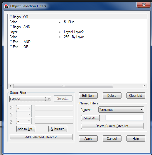

Here is a start Using filter command that selects all objects
--- On a layer with color blue and the object is set to Bylayer (in this example Layer1 and layer2 color is blue)
or
--- The object color's property is set to blue.
It filters by if the objects color property is blue or
if it is on any layer that is blue and it set to bylayer
That's exactly what my lisp does. It's just that the lisp figures out for itself which layers are set to blue. Using filter you need to remember the layer names.
