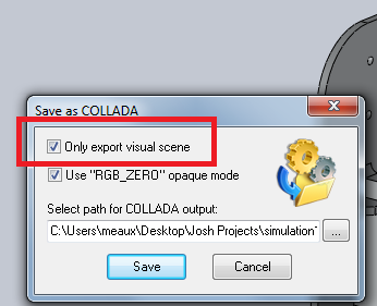

JNieman Posted August 17, 2011 Posted August 17, 2011 In case you didn't know, Solidworks Labs released an add-in to allow the exportation of files to the .dae/Collada format. From what I understand it's a wide-open XML based format for open communication of 3D files with better support for materials (or at least color..) and other info that often gets left behind in some file conversions. Link here: http://labs.solidworks.com/Products/Product.aspx?name=colladaexport However, I am having trouble exporting my assembly. I'm not even trying to export animation information - just the assembly model. I wish to import into Blender, and I'm having bad luck with the VRML format I initially attempted. Has anyone had much experience with the addin yet? I can't find much of any troubleshooting or tester posts anywhere. Could use some help here. :\ Solidworks runs into a fatal error, crashes, and cannot continue. My computer has 16gb RAM, 64-bit Windows 7, with am i7 2600 3.4ghz processor. Hardware should not be the ceiling here with such specs, it shouldn't be running out of memory I would think. I'm working on intellectual-property of a sensitive nature, otherwise I'd upload the model. I just downloaded SW's sample assemblies to see if I can replicate the problem with less sensitive assemblies to isolate whether it's my model or the software or machine I'm running. Will report. Quote
JNieman Posted August 18, 2011 Author Posted August 18, 2011 So I got it to work. (I'm pretty awesome.) One little check box that didn't seem logical to check... needed checking. (Ok, so I wasn't so awesome in this instance) I'll post a screen cap when I get back to the shop tomorrow, for explanation. I'm still curious to get any general input and feelings on people's experience with the Collada file type, hopefully specific to Solidworks exportation. Quote

JNieman Posted August 18, 2011 Author Posted August 18, 2011 Settings used: Like I said, not the most brilliant moment... Just needed to toggle a checkbox. It seemed illogical at the time. Other, smaller, models (of my own, and of SW samples) exported fine without checking that box. The only difference I can infer between models is the animation/motors/motion studies that I've created with the one I had issues with. I was only trying to export the model, not the motion study, so assumed the process was the same. Oh well, it worked in the end. Quote
