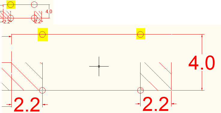

I found a strange behavior of AutoCAD. When I was modifying a drawing and adding dimension annotation, there suddenly come some small circles as highlighted in yellow in the screenshot.
  1. First, there is no way I can't select them.
  2. Second, zooming doesn’t change their size.
Does anyone know what these small circles are? How to get rid of them?

It is possible to be some points (Point entity) there? Please call DDPTYPE command and check which point marker is set. Change if to dot to see if something change.

I tried DDPTYPE. However, it might actually related to dimensional annotation nodes. If I delete the original annotation and re-apply them, these circles disappears.

I guess it might just because some reference points might have been missed. Doing the annotation again solved the problem.
Just a guess, the layer you used is set for that linetype. Change to a layer with continuous linetype and dim again.
