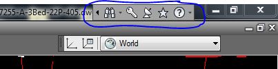

designerstuart Posted August 23, 2011 Posted August 23, 2011 hi all. i want to hide this: as you might be able to tell from the questions i post here, i don't find it much help and want it off my screen forever! thanks Quote
Jack_O'neill Posted August 23, 2011 Posted August 23, 2011 Sure you can. Its just a tool bar like the rest. Unlock the toolbars if you have them locked, then undock it. Hit the "x" in the corner to close it. Then lock the positions again. You can do it through the Tools>Toolbars menu too if you can remember it's name (which I can't at the moment). Just uncheck the ones you don't want to see. I don't have that one displayed either. Quote
rkmcswain Posted August 23, 2011 Posted August 23, 2011 It's not a toolbar. You can disable it using the information found here: http://otb.manusoft.com/2009/03/disable-infocenter-in-autocad-2010.htm Quote
designerstuart Posted August 23, 2011 Author Posted August 23, 2011 great, thanks RK. it worked a treat. for brevity, the link says to paste (vl-load-com) (vl-registry-write (strcat "HKEY_CURRENT_USER\\" (vlax-product-key) "\\InfoCenter") "InfoCenterOn" 0) to the command line. thanks to Owen Wengern at Outside The Box. Quote

Patrick Hughes Posted August 24, 2011 Posted August 24, 2011 hi all. i want to hide this: [ATTACH]29561[/ATTACH] as you might be able to tell from the questions i post here, i don't find it much help and want it off my screen forever! thanks Uh, never mind. Quote

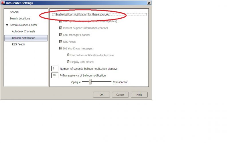

nestly Posted August 24, 2011 Posted August 24, 2011 Story of my life... It kept popping up all sorts of reminders and just irritated the @#$% out of me' date=' so I killed it.[/quote'] I loved the Info Center for searching because you can specify exactly what/where to search (locally and on the web) ... now they've gone and replaced it in 2012 with Exchange, which is far less functional/customizable. If Cadtutor had a middle finger emoticon, this is where I'd insert it. As for the pop up messages, disabling those was literally one click away. Quote
