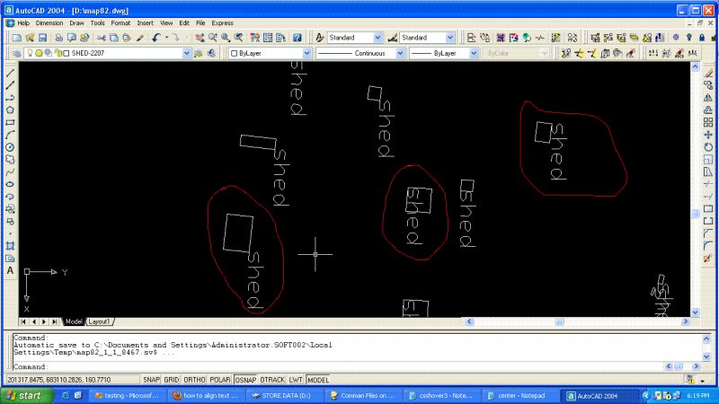

how to align text to center of the polygon
using autolisp program or any tool in autocad 2004.I want to align the text to the center of the polygon.I have pasted the text in end of the each polygon.But now i want to align it to the center of the polygon.It should be worked for all selected polygons.Polygons Size are different.

we have the 3dpolyline drawings not lwpolyline drawings.The message displayed as "1 Found" "1 was Filtered out" For a Single Selected Polygon.

I have attached the sample gif and highlighted the text placed in polygons.I want to align the text to center of the polygon for all single polygons.I have tried more lisp and auto cad 2004 tools but still cannot resolve the issue.Thanks.
What is the justification of the text? Does AutoCAD 2004 have M2P? If not there used to be a LISP for that.

it's not working.i am having more than 500 polygons.please see the above image for reference..
What is not working?
What code did you use? do you have the actual routine to move the text to the center of the polyline?
As stated before, factors to consider.
Text justification
UCS
Type of pline
