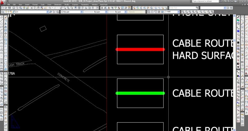

Can it be done like you can with Text etc?
i know it can be done via lineweights, but you cant "lock" the lineweight in model space,
at the mo, to generate a thinkness in a line i use the global width for that pline.
i dont want to use line weights as i sometimes have multiple lines with different widths on the same layer, i could split the layers, but i'd rather not to.
any help appreciated

i've used lineweights before, and didnt like how it works, i found global width in the properties to be much easier and absloute, abd like with annotative text, i can choose which lines i want at what thickness when they are on the same layer easier, and not a "guess" when it came to produce the final drawing, plus the scaling of the width in model space is relative to your zoom factor.
i've used line weights on this drawing, as i need to get it out,
but one thing, in my CTB file, i have line ends etc to be square, i have the correct CTB selected for the layout tab, along with all other print settings. it prints fine.
but when viewing the drawing in AutoCAD or one of the DWG viewers, both in Model space AND in paper space, it shows all the line ends to be round?
any way of sorting this?
i have checked all my line weight settings, etc and i cant work it out.
Aggghhhhh
I need to look at my selections BEFORE posting
i didnt tick the box under the plot style selector that say "display plot style"
thanks for your help
