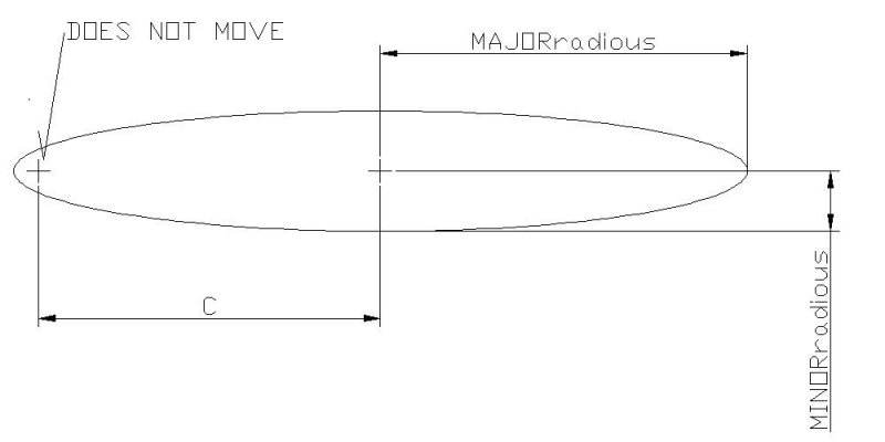

I'm drawing an ellipse. I want to change the size of the ellipse. However, I don't want the focal point to move
C=( ( 1-( (MINORradious*2) / (MAJORradious*2) )^2 ) ^0.5) * MAJORradious
I have this equation on the attachment and color coded for easier reading

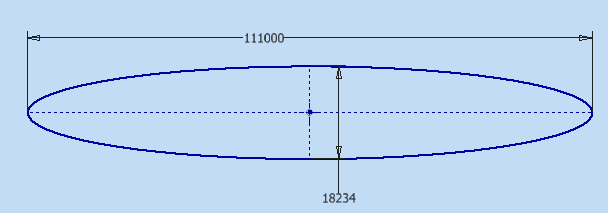

I have drawn it again. this time without any attempt at changing the parrameters.
I have a jpg that explains it better that I'll attach with another email. It tried to attach it this this one but it won't for some reason
ellipse1.ipt
JD

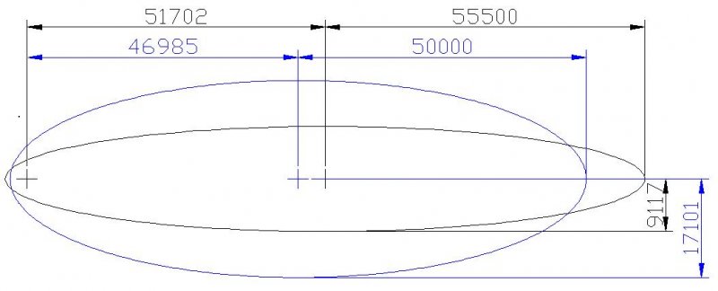

I want to be able to change the size of the ellipse as shown in the jpg. I want the focal point to be fixed.
Just a bit of refrence.
I copied these formulas from a spreadsheet
In the sreadsheet I have majoraxis (major diameter)
Inventor will only dimention the radious of the ellipse.
This is why I wrote (MAJORradius * 2) instead of majoraxis
Eccentricity=(1-(minoraxis/majoraxis)^2)^0.5
focal point = Eccentricity*majoraxis/2
More explanation about the jpg and my equation
focal point = 51702 in the black ellipse
focal point = 46985 in the blue ellipse
