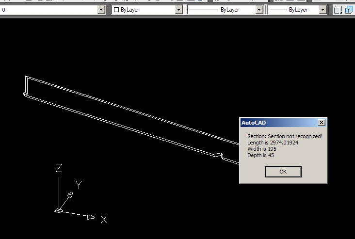

SEANT Posted October 14, 2008 Posted October 14, 2008 This is a proof of concept VBA routine designed to assist BOM generation from AutoCAD 3DSolid structural steel drawings. With the structural steel focus, there was a need for section recognition – I’m not sure if that is of any importance to your project or not. It should, however, find the length, width, and depth of extruded solids regardless of orientation. Based on your swept solid example, it should work for those as well. In it’s current state as “proof of concept”, the routine only process one solid at a time. Some Selection Set filtering and, perhaps, spreadsheet or database automation would have been the next step. I’ve sort of switch focus away from VBA (given it’s dubious future with AutoCAD) but intend to continue this project from the .NET API. Given more spare time, that is. SolidLength.zip Quote

SEANT Posted October 14, 2008 Posted October 14, 2008 There are a couple of things I should have mentioned in advance. The DVB project references the AutoCad/ObjectDBX Common 17.0 Type Library. That should work with 2007, but does warrant checking via Visual Basic Editor – Tools – References. Another thing is that there are two Public Subs in the project. The pertinent one is called “SolidDims_Main”, and if everything is set properly, should give an output as in the attached screenshot. The other Public Sub “SetRegData” is used to catalog profiles – Corner Extrusions, I-Beams, Crown Molding, whatever, to allow for profile recognition. I didn’t bother running SetRegData on the profile used to generate the rafter, and is why the line “Section not recognized” is shown. Quote
