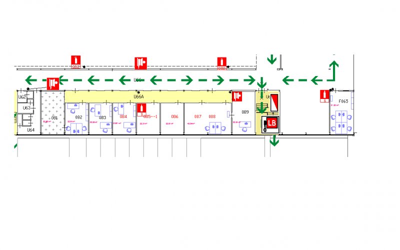

Hi everybody,
i work with emergency plan for a company, many tools which used in to fight fire cases these tools which i can control the size by at annotative blocks in different scales...in these drawing i must have emergency routes (with green lines and arrows as shown in the pic) my question is: which way is the best to draw these emergency routes so i can control on the scale and that make logic zise with annotitive blocks.

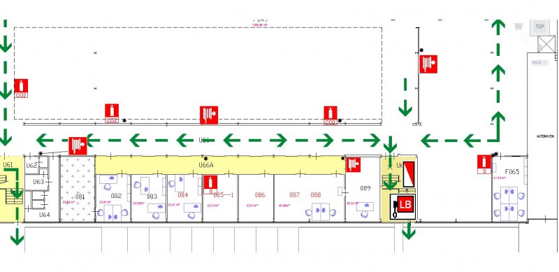

How about defining a linetype for that?
*EXIT_LINE,Exit Path line -- > -- > -- > -- > -- > -- > -- > -- >
A,1,-.3,[">",STANDARD,S=1.5,R=0.0,X=-.1,Y=-.75],-1.5
Create a new file with LIN extension to store the code above or append it to your acad.lin file. Also, please fell free to play with numerical parameters to adjust the appearance to your needs.
Regards,
Mircea
^^^ that's good.
or dynamic block with array action.
