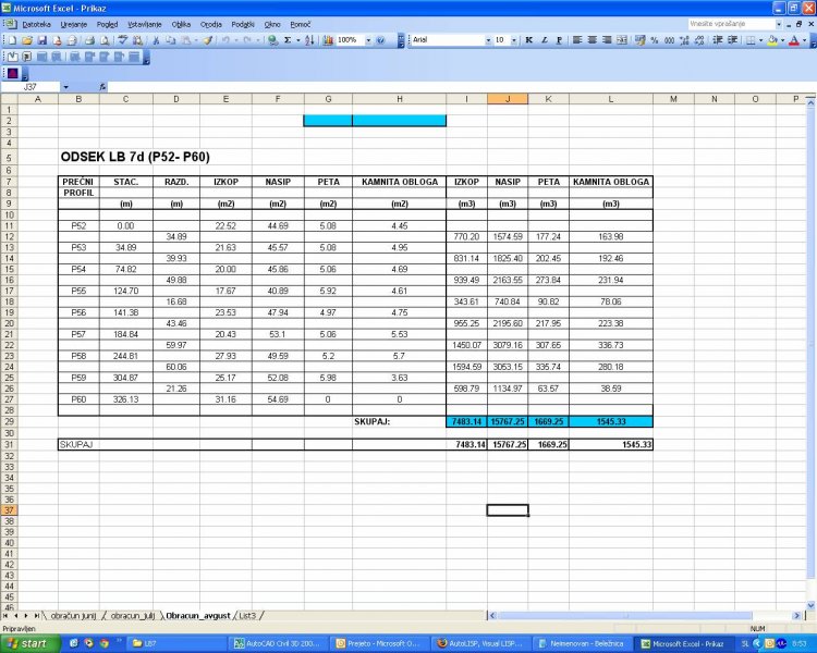

I start to use your program Area Label from MAC LEE, but i have some question about it, if could be changed.
It a good program, must say.
I work in civil engeeniring, and i start to use this program for calculating areas of polyline in profiles. Now the resault get in rows, and i tried to get it in colums, but unfortunate. I change the table, but the resault dont suscrabe in colums.
I would like to know it is posible to get the resault in colums (Digging, embankment, gravel, humus,...). That wolud then help easy to calculete the volumes of materials. Additional would be able then to end one profile and to start the other, but then in next row and then attach the resault to table of previous profile. Additional how would be able that would the program read the name of Layer and then sort it in the appropriate colum, that would be earlie defined (Digging, embankment, gravel, humus - the colums of table, and then i would click the polyline of gravel in profile and the program would suscribe the resault in the colum of gravel, and not at the start of the first colum). That would be usefull, because some profiles don't have the same materials.
Now if its a easy project (not alot profiles), i do the profiles with Civil, because its got that the profiles are dinamic if it is changes something, that suscribe it and calculete, but it take alot time to do a good surface. We have some other program for profiles but are not dinamic, we have to draw the materias alone, and if we change the area, than we have manual change the resault (excel) and calculete it,...
Now if it could be everything done in AC, than we could take the tabel out an insert it into excel or we could do AF (to file) and then repair it in excel,...
Something like this (we have to add the volumes of material with the profiles).

I'm glad you could find my program useful, however I am not looking to modify this program to the extent that you describe to suit the needs of one individual.
Just thinking out load :o ... would it be possible for you to use Excel's VLookup/HLoopkup function to achieve what you wanted? I.e. the "table" generated from Lee's code you simply use as a form of "database" then your resulting table uses one or more of the lookup formulas of Excel to extract the relevant data items from the table generated by Lee's code.
It's how I used to do it from the table generated through Data Extract. I left that file as is, so I could simply overwrite it whenever I needed to update the areas. Then all that needed was to open my calculated Excel file and the updates would be extracted automatically.
Irneb thanx, i will try this to do something with this,....

I don't know about "dynamic" ... perhaps you should look into the Data Extraction rather (where you can specify which properties of what type of entity on which layer, etc. etc. etc. and then have it placed in various columns into an XLS file). But I'm not sure exactly what you're after.
I will rather use eattext and than export to excel.
