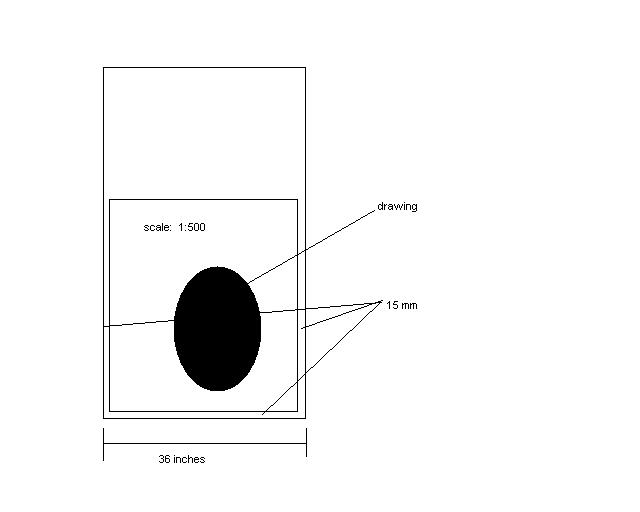

Seth385 Posted September 1, 2011 Author Posted September 1, 2011 This is how its supposed to look like when printed Quote
ReMark Posted September 1, 2011 Posted September 1, 2011 Well first you would have to switch to a layout, right-click on the Layout1 tab and select Page Setup Manager. When the Manager opens click on the Modify button. This will bring up the Page Setup for Layout1. Select your printer/plotter, select the paper size, set plot scale to 1mm=1 unit, select your plot style table, and finally set the orientation of your paper to either portrait or landscape. I do foresee one problem already though. It appears this is a metric drawing but you are specifying imperial sized paper. In my opinion this just leads to confusion thus the output is never going to be satisfactory. Metric units...metric paper size. Imperial units...imperial paper size always works much better. Looking at your list of layers I noticed you have one named "View", color "magenta" set to "no plot". I take it this will be the layer you will be creating your viewports on? Quote
Seth385 Posted September 1, 2011 Author Posted September 1, 2011 Thank you, solved the problem. problem was with paper size and metric and imperial units. Had to change orientation and paper size. Thank you again Quote
