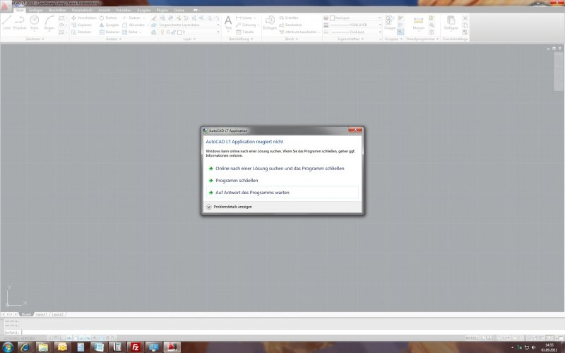

Dag Posted September 1, 2011 Posted September 1, 2011 Dear experts, first of all let me say that I am from Germany and my english is not so good, so if someone find a spelling misstake, feel free to keep it . All expresions in this text has been translated because I am using the German version of AutoCAD so they might be diffrent from those you know. I have been looking for a solution in German Forums but we couldn´t figure out a solution yet. Therefore I have to rely on your help. The Problem: When I try to save under or open file AutoCAD collaps. (The window is getting "untouchable" and at the top is written: "(no reply)" in german: "(keine rückmeldung)" I assume everyone who use Win 7/ Vista knows what I mean When I deinstall then Install the programm new It works for a cupple of hours, than the same problem appears. (I choose the folder to save in: P:/... witch is the server. This might be a hint for someone?) System: -Windows 7 Proffesional 64bit -pentium dual core E5800 -AutoCAD LT 2012 Installation was made as admin! The problem was there before and after installing windowns update. Thank you for your help! Best regards from germany! Quote

SLW210 Posted September 1, 2011 Posted September 1, 2011 What exactly is not working? Do you gewt anything on the command line? Quote
Dag Posted September 1, 2011 Author Posted September 1, 2011 when I push "save as" or "open file" following screen apper after a few seconds... Quote
Dag Posted September 1, 2011 Author Posted September 1, 2011 hope you can recognize everything... Quote

Dag Posted September 8, 2011 Author Posted September 8, 2011 Hi again. I changed the card because in the link from Nestly was a forwarded Link to CAD where the certified card where listed. As we had a graphic card here we decided to build it it. It is definitely better than the old onboard grapic card. However, the problem is solved now. I had an expert here who noticed that some "services" (not sure about this expression, German:"dienste") where deactivated when starting windows. He activated them and now it works. Tanks to all for your Help! Regards from Germany! Dag Quote
