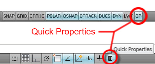

How do i turn off this info pop up?
There is a button at the bottom of your screen. It will either be an icon or have the letters QP on it. Just click that button to disable Quick Properties.

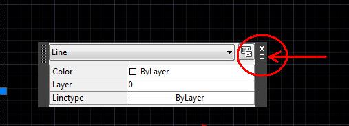

Cad64 posted the best solution, but you can also click the "Options" button and disable it directly from the popup if you forget the name of the feature.
