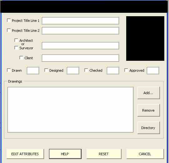

Though i'd really like to be able to add drawings to a list in a vba dialog box..
I've set up the dialog box as per the attached image.
I just need to know how i can use the add button to select drawings then add them to the list to be edited.
i mean im after some code to do this.
Cheers

Thanks for that borgunit - ive got the dialog working but just need to work on passing the path to the list box.
Thans for your help its a great start - cheers
